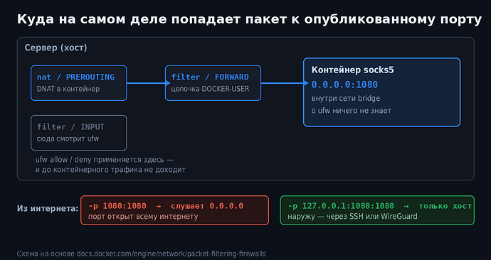

Trap 2. UFW does not close container ports
Classic: the administrator runs ufw deny 1080/tcp, checks ufw status, sees DENY — and the port still answers from outside.
Diagram based on Packet filtering and firewalls | Docker Docs
Official explanation: “When you publish a container’s ports using Docker, traffic to and from that container gets diverted before it goes through the ufw firewall settings.” The technical reason: “Docker routes container traffic in the nat table, which means that packets are diverted before it reaches the INPUT and OUTPUT chains that ufw uses.” The result — “Packets are routed before the firewall rules can be applied, effectively ignoring your firewall configuration.”
Do not treat ufw status as proof that the port is closed. The only reliable check is to try to connect from another machine:
nc -vz vps.example.com 1080
Connection refused or timeout — good. succeeded — bad, regardless of what ufw shows.
There are two practical options, and the first is preferable:
- Do not expose the port to the outside at all —
127.0.0.1:1080:1080, as above. Then the firewall question for this service simply doesn’t arise. - If you still need to publish everything — filter in the
DOCKER-USERchain, which is processed before Docker rules, or use the well-known ufw-docker rule set. This is discussed separately on the forum: UFW-Docker: how to close Docker container ports and set up ufw firewall.
