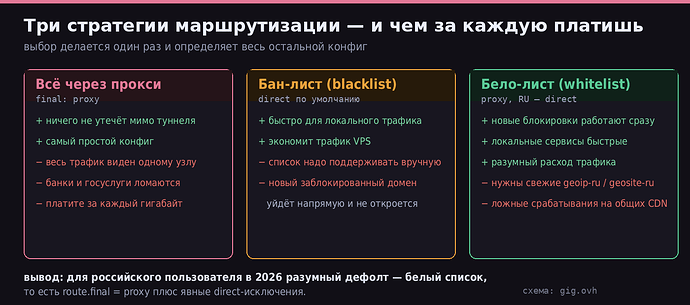

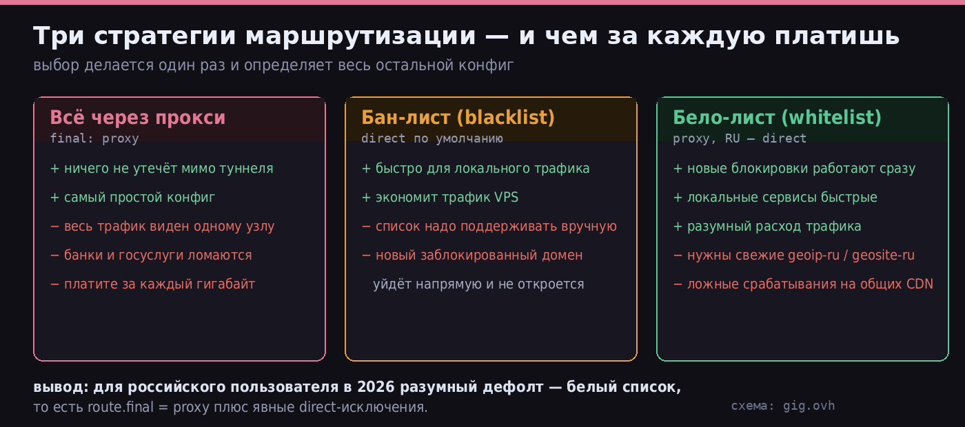

Layer 0. Decide your strategy first, then write the JSON
Before opening the editor, you need to answer one question: what happens to traffic that doesn’t match any rule? The answer determines everything else.
Key principle: rules describe exceptions, and route.final describes the default. Most broken configs are attempts to describe everything with rules at once, instead of choosing the correct default and then adding a dozen exceptions.
For a Russian user in 2026, the sensible default is a white list: final points to a proxy, and direct is given only to explicitly listed Russian addresses and domains. The reason is simple: the blocklist grows faster than you can fix it, while the list of things that should go directly (banks, public services, local services, gray IP ranges) hardly changes.

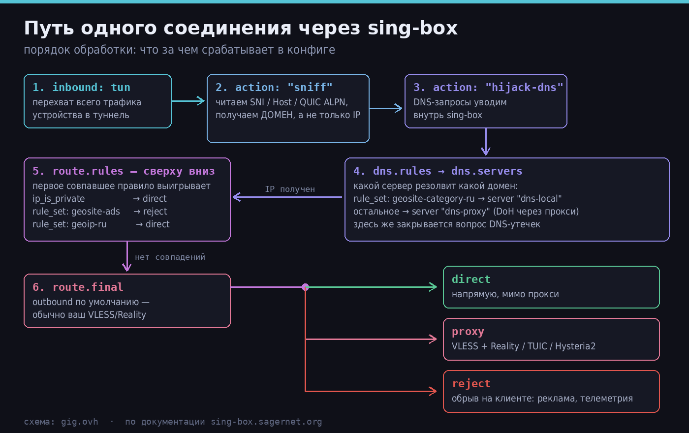

Layer 1. Traffic intake: tun and why sniff is needed
The tun mode creates a virtual network interface and takes over all system traffic — not only the traffic the app agreed to send to the proxy.

Why domain-based routing doesn’t work without sniff
When traffic comes from tun, sing-box only sees the destination address — IP and port. There is no domain: the app has already resolved it itself. Rules like “youtube.com — through proxy” operate on domains.
This is solved by the sniff action: sing-box looks at the start of the connection, extracts the SNI from TLS ClientHello, Host from HTTP, or ALPN from QUIC — and then routes by domain.

Layer 2. DNS — the place where almost all breakages happen

Layer 3. route.rules: first match wins
This is the core of the whole construction. Rules are checked top-down, the first one that matches fires, the rest are not considered. Hence the main practical consequence: the order of rules is part of the logic, not cosmetics.

Actions (action) that terminate processing:
  • route — send to outbound (field outbound; field outbound in the rule itself was deprecated since 1.11.0 in favor of action);
  • reject — terminate. There is method: default (TCP RST / ICMP port unreachable), drop (silently drop), reply (only for ICMP echo);
  • hijack-dns — send to the DNS module;
  • bypass — return to the system stack (Linux + auto_redirect, since 1.13.0).
And not final: sniff, resolve, route-options. The latter is a set of tuning over the route: override_address, override_port, udp_timeout, as well as tls_fragment and tls_record_fragment (since 1.12.0), which cut TLS ClientHello into parts — sometimes enough to bypass primitive DPI without a proxy at all.

The order of rules here is the logic: first the technique (sniffing, DNS interception), then the local network, then ad blocking, then “my own — direct”, and only after that the default to proxy.
