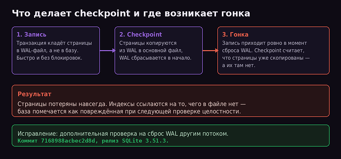

Diagram based on the analysis by Tailscale and Write-Ahead Logging
The mechanism, as explained by Tailscale: if a write arrives at a specific moment during a checkpoint, “the checkpointing process gets confused — it thinks some of the pages have been copied from the WAL into the main database file, but they haven’t.”
Next comes the chain that makes the bug destructive: “Those pages never get written to the database file, and that data is permanently lost. The database file becomes corrupt, because other pages which reference those pages — such as an index — are written to the database.”
In other words, not just data is lost. Pages that other, successfully written pages reference are lost. The index points to emptiness — and the file becomes structurally corrupted, not just incomplete.
The age of the bug was estimated by SQLite developers at at least 16 years. Conditions for triggering are rare: manual control of checkpoint combined with an aggressive frequency of their runs. So rare that for testing they had to add code that deliberately triggers the race.
